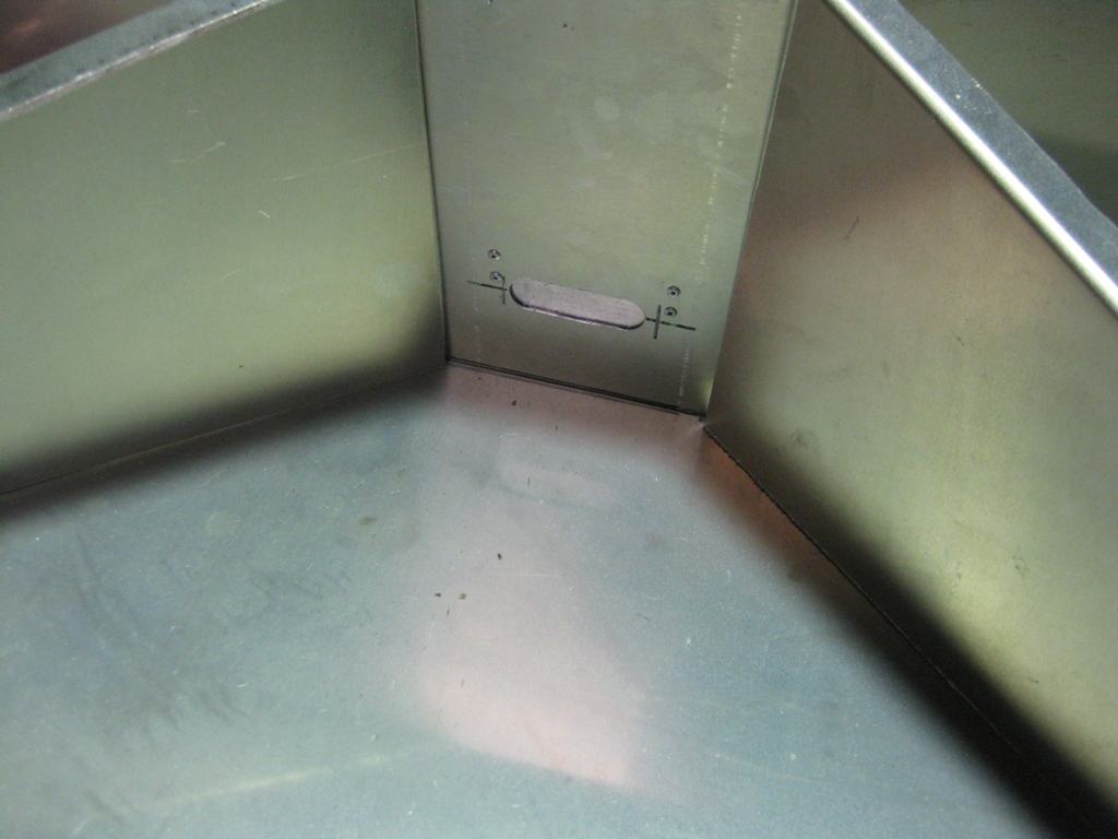

Internal Baffles
An internal swirl pot with flap valves to keep it fed with fuel.

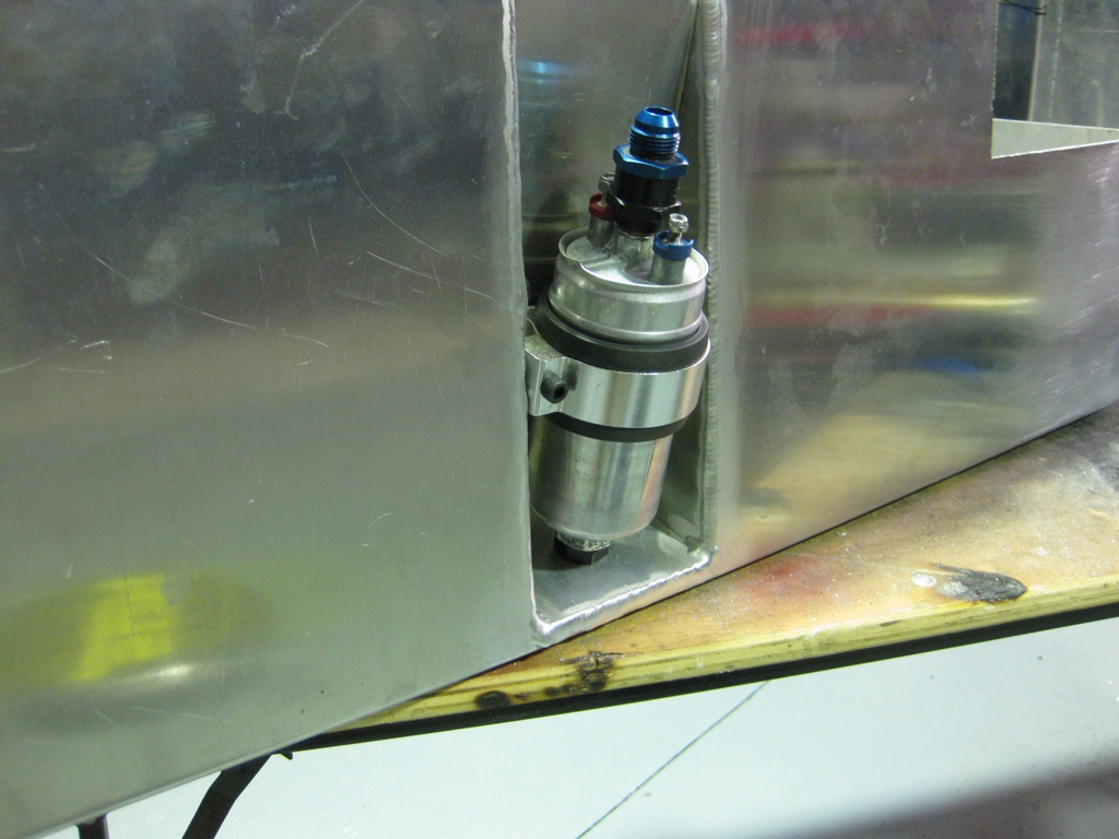

An External Bosh 044 set up to pick up fuel from the bottom of the swirl pot. I did it this way because I already had the pump and also for ease of servicing as you can just unscrew the pump to replace it without having to get inside the tank.

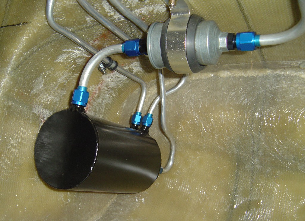

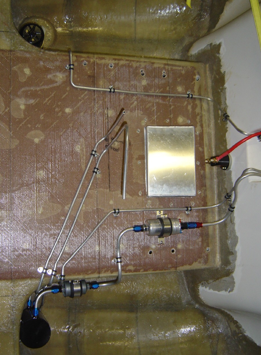

I also only have a single hard line from the tank to the engine, I have my swirl pot in the tank and a reg right next to the 044, it is still loud, but can only just hear it at idle
<img src="http://www.clubcobra.com/photopost/data/500/200903040013.jpg" />
http://www.clubcobra.com/photopost/d...0903040015.jpg
http://www.clubcobra.com/photopost/d...0903040013.jpg

It's a shame you didn't internally mount the fuel pump as I too can attest to the noisiness of an externally mounted 044 pump.
I had Marty modify the stock G-Force tank to enable me to fit a standard BA or BF fuel catch can and level sensor and this was very much quieter and even easier to fit into the car, particularly when I used the stock plugs to connect up to my loom.
As to accessing the pump I will simply be unscrewing a lid in the boot floor to access the top of fuel tank and the bolt mount points for the in-built swirl pot.
Presume it is too late or too messy for you to revise the pump set up but most modern cars now run in tank pumps as you'd know and with great success of course.
