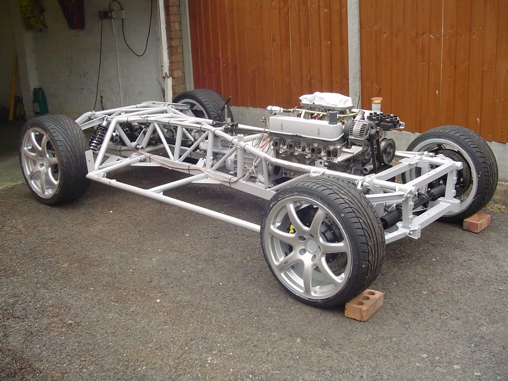

Neat looking chassis. Looks a lot like a TVR chassis.

Here's the TVR Chimera chassis as a reference. I reckon the folks at RAM might have got some inspiration from this.
http://i685.photobucket.com/albums/v...3.jpg~original
David Hodgson 08-30-2015 06:25 PM
I see the connection Mike, but it might be the other way around. I'm sure the RAM was in production in the 80's.
A bit of googling shows the TVR Chimaera between 1992 and 2003. Also the RAM chassis was designed by F1 and Indy Car designers: David Rendall and Adrian Reynard.
