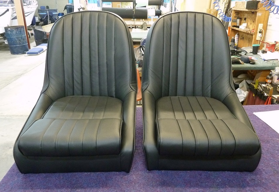

My seats came from PACE in Qld. They were supplied as bare aluminium 'buckets' and are ADR/registration compliant. Bare headrests (now padded and upholstered) were included.
I had the seats upholstered by local marine upholsterer. He did a nice job; comfortable too :)
Here they are....(headrests not shown in this pic)

xb-60 12-06-2021 07:03 PM
1 Attachment(s)
Originally Posted by BJ's Snake (Post 1500443)
I would have to measure the width between the tunnel and side panel but as a guess the Pace is wider.
Can measure later in the day if you want or maybe someone with a Pace can do it for you now. Glen is online.
Gary, the minimum width measurement for the (PACE) seat fitment on my car - same as BJ's - is 460mm (see pic, where the carpet starts) ....and the width of my upholstered seat, at the base, is 400mm.
The seat easily clears the handbrake.
Attachment 36803
Glen
