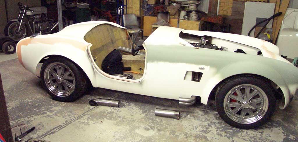

Cameron Parsons 12-15-2003 11:38 PM
1 Attachment(s)
I got 225 and 295....
They will look good on these........ mmm Knock On's
