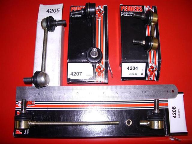

I've asked them to look at a slightly different design which is 100 wider and has 3 adjustment holes. Making the bar wider should make the bar work with less effort and the adjustment holes give 3 stiffness settings. The rear measurement is 400mm as this will allow the bar to be mounted directly to the 2 square sections under the diff housing. The pedders 4204 links could be used to attach to the lower arm, they are only 60mm long between centers at about $55 each

Heard back from Pedders today, the same bar as Phil is $225ish with saddles and bushes. This bar is 615mm between lower arm mounting points and can use a cut down link like the 4208 jobbie from Pedders with the balls at 180 degrees to each other and 500mm across were the saddles mount.
The stighly different bar than Phils is $242 which comes with saddles and bushes and 3 adjustment positions. This bar is 100mm wider which should sit even with the mounting holes in the lower arms and use the 4204 link and is 400mm across were the saddles sit, (noticed I said should).
