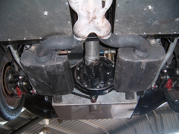

400TT 07-03-2007 05:01 AM
Les, maybe something like this...
http://www.clubcobra.com/photopost/d...m/diff_010.jpg
Rebel1 07-03-2007 05:07 AM
Craig.....certainly worth considering.
Might be just the solution.
Thanks heaps
Les
