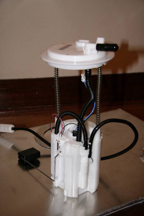

Ok, the pic below is from my gallery. What am I missing, apart from the obvious fuel line to the engine, currently capped off on the top of the pump. Thanks.

Your fuel pump is different to mine Sambo.
Mine has 3 outlets at the top.
It looks to me like the T piece I am refering to is built inside your pump assy, so there is no need for it outside the tank.

they usually all have 3 lines
middle one is charcoal canister vent
the pip ethat uis snapped on yours is either return or feed
either try to screw a pipe onto the broken bit or buy a new pump
i personally would buy a new pump
60 psi of fuel pressure is probably not a good thing to have a pipe break and fuel go everywhere
about 1 in every 5 2nd hand fuel pump assemblies i work on have broken bits
then u have to make sure u get the corect fuel gauge to match the feul level sender in the hiolden pump assembly
another prob is holden changed the reistance values half way thru vy pumps depending if hsv or monaro or std

Mine's a brand new, unused VZ Crewman pump and nothing's broken mate. I think the only thing missing is a lump of alloy with 6.0L bored out of it.
