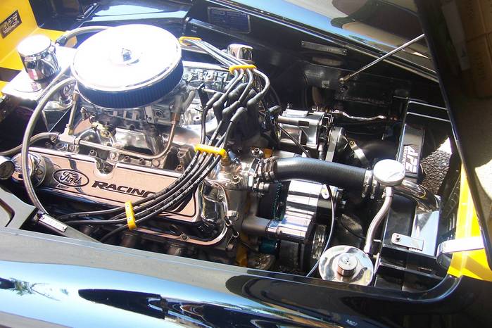

Although my 347 has yet to breath fire, the build is completed.
Although I am biased I think the twin Impco setup looks pretty good.
Attachment 13533
All good bits in it and 11:1 compression should work nicely with the AFR heads.
Should be putting in the drive train in the next two weeks, then its down the list
Pedals, electrics, gas tank, dash, seats ......go cart driving

boxhead 11-26-2007 11:39 PM
Yep I have to agree, it sure does look good.
hogster 11-27-2007 01:56 AM
And its the right kind
Aussie Mike 11-27-2007 02:14 AM
Ally heads, plenty of comp and probably a cam with good exhaust lift and duration and that thing is going to fly on gas.
Your twin mixer setup looks the business. I was contemplating doing that on a tunnel ram with twin mixers for the Cleveland in my old F100. I figured the long straight runners in the tunnel ram would work well with gas and I could pull lots of cold air in through a hole in the bonnet.
hogster 11-27-2007 02:26 AM
A tunnel ram would be great. I even looked at supercharging, but I think the ultimate gas system is liquid injection, which is not yet domestically available. The advantage is the cold gas temperature as it changes from liquid to gas creating the ultimate cold air induction.
I had a few issues with fitting the impcos to an edelbrock manifold, which dont fit holley. Then you get the adapter plates and they fit, but the gas lines run in front to back, which doesn't work with the spacing and distributor etc......so more adapter plates......but I am happy with the result.
The cam is not too aggressive but I was trying to find the happy medium between power and drivability. The engine builder "Eddie" tells me that even though it isn't a big block, it will have dillusions of grandeur and be plenty for the cobra. In standard trim with a stock 302 windsor (1140kgs)

Gotta love the 347!
Mine's now 2 years old with 14000km on it and running very well.
What cam did you use Hogster?
Richard
LoBelly 11-27-2007 07:14 PM
that's a very nice looking engine and like Richard says gotta love the 347.
have just started to drive mine and the extra grunt is great.
I suspect with that setup you'll have plenty of fun.

hogster 11-27-2007 08:17 PM
Richard,
Used a Comp Cams Magnum Hydraulic Roller
Part 31-442-8
Duration 284/284, Lift .533/.533
For 2500-6000 RPM
This is what I was told would go hard enough, but not shake the gauges out at idle.
