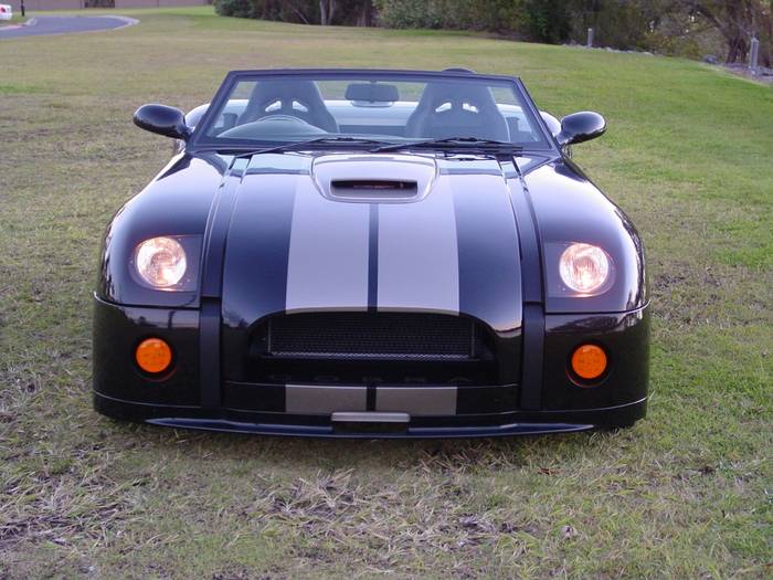

Sorry newbie question. Does anyone know how this car would handle compared to the origional cobra? The weight should be pretty similar, but the dimensions are totally different arent they? Its a pretty wide car. Wonder how that would affect the handling?

Regarding cost. I'm sure Warren can provide more detail but I have been looking into this as a project and the basic costs I have come up with so far is the chassis for $22,000, a donor car for around $12,000 (I'm told you can pick up a written off XR8 for around $12,000. I'm trying to get to an auction later next week which has an XR8 6 speed auto up for sale. If I get there I will let you know what it goes for). I don't believe the standard seats and fuel tank fits the Cobra chassis so that is an additional charge, and I guess things like carpets and door trims would be also be additional. I would have thought you could do this for around the $40-$50k mark.
WKB 11-06-2008 10:10 PM
gpbonner,
$12-$14K should be the price for a BF XR8 depending kilometres and damage. $50- $60K probably closer the price range and this also depends on the amount of work (upholstery/paint) you can do your self and the price of the wreck( I know a person who bought a BA wreck for $8000).If you want the replica mags that will add a fair bit onto the price as well.
Apart from the doner car you will need seats, fuel tank wiper mechanism, gas struts for the bonnet, bonnet latchs, insulation, front shocks and coil overs, rear springs, lights, exhaust, interior trim and some other sundry items.
Mike,
This car is heavier than an AC Cobra. Dimension wise it has a 100inch wheelbase, marginally longer than my AC Cobra and wider than a Falcon. Just fits on my car trailer width wise(tyres miss the the mudgaurd by only mm's.

i have about 85% of everything from a wrecked ba fairlane which i got from auction that had an engine bay fire , wrecked the body after gutting it , the motors wiring fuel lines and anything plastic in the engine bay coped the fire and have replaced most of this , had the heads rebuilt and worked (only 3valve heads) , almost finished rebuilding the engine with a whipple supercharger from a f series (hence the clearance question) and was going to drop this in to a 77 zh fairlane

WKB 01-13-2009 04:27 PM
wodahs,
In the picture the red through the scoop is the top of the plenum on the motor. If the supercharger is any higher than a XR8 motor it probably will be to high. If you fitted a supercharged engine to the 540 it would make engineering and registration interesting.
