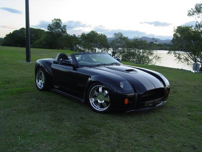

I guess that everyone has seen this one before:
http://www.clubcobra.com/photopost/d...C540_Cobra.jpg
