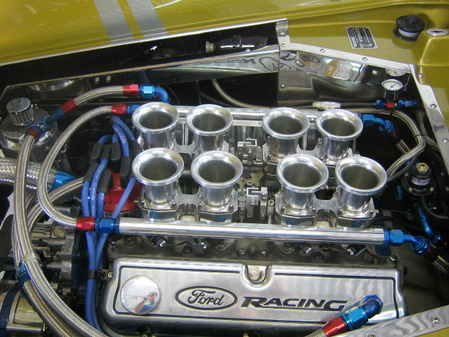

The throttlebodys do look awesome,
its a DC+O 45mm setup that Dru originally had fitted to the Harrison Daytona.
They made good topend HP on the 302 but gave up a lot of midrange torque over the GT40 long runner intake I was using,

Found a couple of pics,bit of a plumbers nightmare...
http://www.clubcobra.com/photopost/d...lebodys001.JPG
http://www.clubcobra.com/photopost/d...lebodys003.JPG
Philm 08-15-2008 02:45 PM
Looking Good Pete,
That is the same set up that I have, they work really well.
Who ever wired up that manifold needs a pat on the back.
The trumpets look a little short, could be the photo angle, mine are 100mm from where they attach to the throttle body. Owen at DC&O has these in different sizes, I had to replace a few when builing the air box.
Is there anything I can do to help John finish the GT40,:3DSMILE:
The plumbing is where I spent the most time on my engine bay, there is a lot going on and no matter what you do it looks busy.
So you haven't run with the stroker yet? I am sure your mid range torque issues will not be a problem.
I am a fan of the 8 throttle body and nothing looks more horny that a small block windsor dressup up like yours.
Phil I did the wiring,
tried to hide as much as possible,now running Autronic SM4 comes with a nice flying lead harness..
Yes trumpets are thew shorter of the two DC&O make 65mm I think,would prefer the 100s but would put them too close to the bonnet for the filters ,at the moment just running socks,yet to do cold air...
