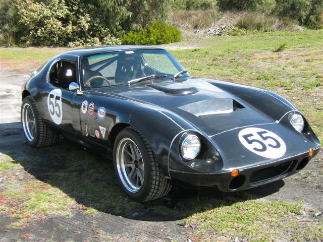

Got my FFR Daytona on the road this weekend. What a blast to drive.
http://www.youtube.com/watch?v=dAocT83wkGw
The steering feels great with plenty of feed back. The 3.5 LSD makes the engine nice and sharp. The complete kit is an awesome car to build. I really like the feel of the Alloy Kirkey race seats. The brakes have the wrong size master cylinder as the pedal is very hard to press, I need to swap from 3/4 to 5/8's to get a better feel.

The wheels are Team III from Richard Oben in the US.
Rear 17x 11 and fronts 17x 9.5 . I have spinners and nut covers to go on after rego. The single system choker exhaust really knocks the power off but does the job shutting it up.
