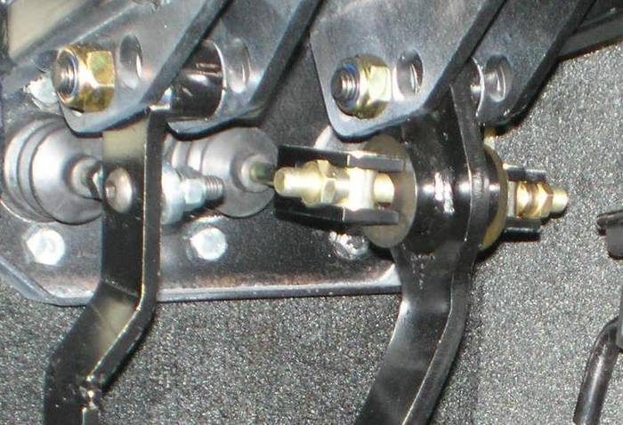

Hi Gregg, in one of your posts on this thread you said that youve fitted a brake bias setup on your car. Any chance of posting a few pics of where and how you did it?

gjkrv8 03-26-2009 02:02 PM
Regards.
Hi Mando,
I think it is either a custom job by Ian or a Tilton brake bias bar.
(As I got a rolling chassis the pedal box was already installed)
I believe you can get a remote adjuster knob for this set up but I am told the Engineers dont like this as they dont like the brake bias being able to be adjusted from inside the cabin by the driver.
picture below:
http://www.clubcobra.com/photopost/d...Brake_bias.jpg
Rgds
Gregg
Mando 03-26-2009 04:29 PM
Thanks Gregg, Thats the same setup Ive got. I thought you had installed one onto the brake lines for adjustment. Is the 3rd brake light one of Ians or from something else. Could you post a couple pics of the light.
