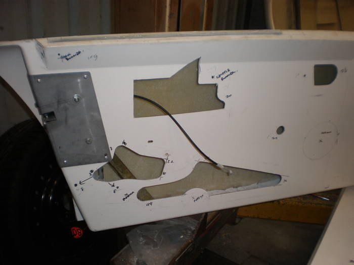

All of the inside of the doors is cut out for the windows, the slot for the window on the top of the door is cut almost, just waiting on some final measurements to complete it. Once I get the door trims I will cut the final holes in the door for the speakers.
http://www.clubcobra.com/photopost/d...or_Cutouts.JPG
I want to finish cutting out the doors and fit the heater (in case the dash has to be removed) before I send it to the painters. I have been putting the painting back since April.
Warren

Hi Warren, Plenty of cutting i see,has Peter let you know the time frame on the glass as yet.I have already purchased the door trims along with all the fiberglass fittings needed from Peter. One thing that im interested in is what window scrapers is he using on the doors and will it be mounted to the trim or to the actual door on the inside.This might mean having to cut or replace these trims depending on the way it is done.

I havn't heard when the glass will be ready. The window scraper for the inside will be the one from inside of the Falcon door with the clips removed and glued into place and glued in place on the top of the of the door. Along the top edge of the scraper you will notice a small flap. The top edge of the door trim will need to be peeled back and the fibreglass cut back a small amount and the trim re-glued. The edge of the door panel should then slip under the flap on the scraper. I don't know what the outside scrapers are yet.
Have you got the fibreglass adapter parts from DRB to fit onto the heater/air con unit?
If you havn't picked up the S2000 mirrors have a look at the late moodel MX5 mirrors. They look a bit easier to fit, available new, but no blinker units available for the covers.
Warren
