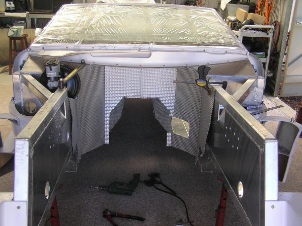

Paul i have used the ACL heat shield $265.00 a sheet need four of them to do a good job easy to cut and bend.http://www.clubcobra.com/forums/pict...d=1073&thumb=1

http://www.clubcobra.com/forums/pict...pictureid=1073
Sorry i try a bigger photo for you to veiw
