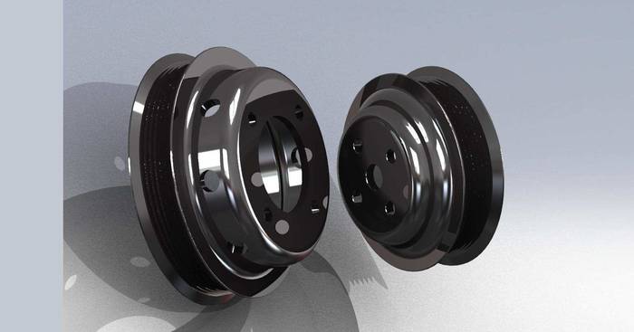

Computer schematic from the machinist of the ally pulleys being made:
http://www.clubcobra.com/photopost/d...m/Pulley_2.jpg

Merv and Sharon 07-28-2009 04:06 AM
I have my new pulleys - laser measured and made from billet ally by Yandina metal fabricators.
http://www.clubcobra.com/photopost/d...ulleys_new.jpg
Quite pleased.
Merv

Merv and Sharon 07-29-2009 11:40 PM
All done. Sound really much nicer than the Gilmer.
http://www.clubcobra.com/photopost/d...nd_Pulleys.jpg
Fabricator has saved the specifications on his computer/laser cutter:
Advanced Metal Turning
4 Harvest Rd., Yandina QLD 4561
(07) 54468679
www.amtyandina.com
