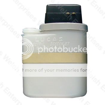

This is what I'm going to use. It looks period correct and I will use a monetary Lucas switch on the dash.
http://i609.photobucket.com/albums/t...rJaguarXKE.jpg
I got it from Welsh Enterprises, Inc.:
Welsh Enterprises, Inc - Jaguar E-Type Series I Electrical Windshield Washer & Wiper Parts - E-Type Lucas Washer Bottle Assembly
$110
Legally, I don't need it in Vermont but I am building a car that I will be driving in all kinds of weather.
George
