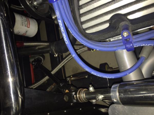

Cashburn 03-13-2017 08:09 AM
Can you post a picture of the end of your steering column where it connects to the U-Joint assembly shaft?

Ozzie Goat 03-13-2017 06:28 PM
I think he meant - pop the hood.
Image of the end of that rod. There will be a U-joint.

REY 427 03-27-2017 06:44 AM
2 Attachment(s)
Sorry for the late response. See attached pictures.
Ozzie Goat 03-27-2017 07:36 AM
Let the experts tell you, but your installation looks different than mine.
More of the black rod showing, more severe angle.
Don't know about related vibrations.
I have more images, if they would help.
Roy
http://www.clubcobra.com/forums/pict...ictureid=16405
edit: isn't that u-joint rubbing the inner fender and/or the hard brake lines there ??
REY 427 03-27-2017 07:45 AM
Roy
I see what you mean, but no there's no rubbing there. Might be the angle of the picture but there's little room there, enough for it not to rub.

REY 427 03-29-2017 08:15 AM
Roy
I think I figured out why mine looks longer. I have power steering and it looks like it was extended to clear to power steering pump. Still can't figure out how to solve the vibration issue though.
