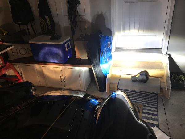

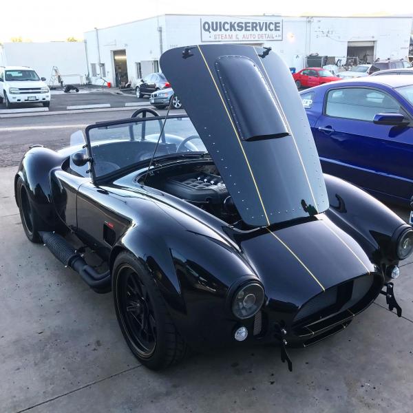

Previous headlights:
http://www.clubcobra.com/forums/pict...ictureid=16402
Halogen headlight versus LED headlight:
http://www.clubcobra.com/forums/pict...ictureid=16394
http://www.clubcobra.com/forums/pict...ictureid=16395

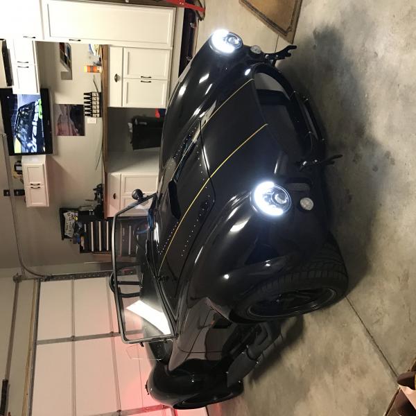

Blinkers/hazards (don't know why it's showing up sideways):
http://www.clubcobra.com/forums/pict...ictureid=16404
