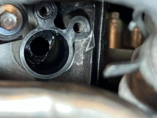

I decided to tinker around more today. I pulled the PCV valve, vapor hose and the fitting at the intake that the hose clicks into. I noticed quite a bit of oil at the intake fitting. Unless this is normal, I'm concerned. The PCV valve clicks back and forth when I shake it. From past experience that would be normal operation? If something is wrong, please let me know how to proceed. Thanks.

The nut shells don't have enough mass to affect a knock sensor, and if they did the VCT won't split out on one bank. Would be Pi$$ poor design to have the engine have one bank producing more power and firing out of time.
The PCV oil is pretty normal and can be eliminated by adding a catch can. Usually needed as rings have more blow-by via age or Super/Turbo charging.

The oil is not enough to worry about and a catch can will only make the catch can manufacturer richer and add no value except give you one more thing to look at and fret about.
