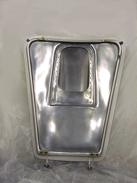

Skip, This is a seamless aluminum plating that we here at Metal-Morphous have applied to many fiberglass cobra hoods. I just figured I would get the ball rolling

Ron,
That looks SUPER!
What's a "ballpark" estimate of what that would cost to have done by you.
Thanks!

Ron,
You need to update that photo with a Backdraft hood... got any?

Jay It just so happens that I have a Backdraft hood in the shop this week , it should be finished by the end of the week and I will post a picture here. BTW its a very nice hood, first Backdraft we have worked on and I'm impressed

Metal,
I do like the look of the aluminum under the hood. But, it would cover my Carroll Shelby autograph. (Before you ask, yes, I paid for it!)

Skip I got it, you can hang the autographed hood on your wall, that why you can see Carroll's signiture all the time, then order a new one from Jay at Vintage motor sports, hes right around the coner from us, almost like one stop shopping that way you can have the best of both
