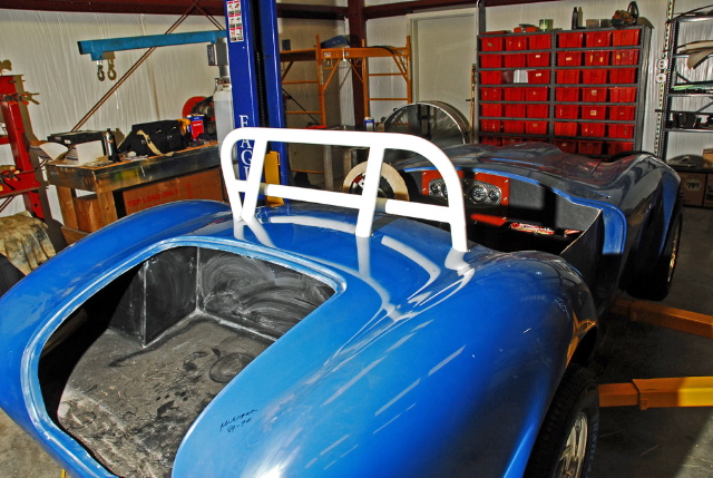

Hey Buzz, a single forward braced bar would be $195 (front braces are quite long) in 1 1/2" .120" wall seamless DOM 1020. That is the same tube we use for the SCCA roll cages I've made. The last stainless bar I made was $300 and that was in a brushed finish 304 ready to be polished. I typically make roll bars as a (very complete) kit that needs to be assembled and tacked in the car. Then they get removed and welded, benched and finished. Some guys chrome, some paint and some powdercoat them. If you could take some good measurements for me we could make it complete here and ship it. Last overseas inquiry I had was in Germany and the best price I could get to ship it was $340 or something crazy. We may want to check our options (prices) on that first. I tried to post the pic from my gallery of the double wide bar I made but I'm picture posting challenged..........
mickmate 02-19-2009 07:49 PM
If at first you don't succeed
http://www.clubcobra.com/photopost/d...umbs/Toms3.jpg

Two roll bars look great if you've got a Z3 or Boxster....not so great in Cobra. After 11 years of building, I would rather go with a single on the passenger side than two bars. Given the rough loud ride and wind, my regular "copilot" is my son, NOT my wife. At age 12 he's well below roll bar height anyway. When he grows I guess I'll move the bar to his side, or just let him drive. :)
