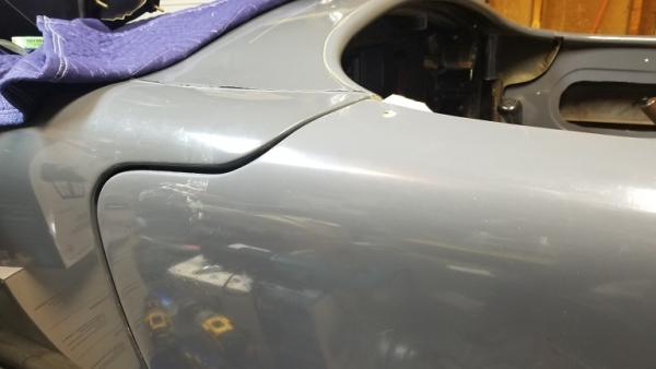

Door latches have been installed. (I had really open the holes on the door to the point where I had to cut beyond the internal metal frame)
I am contemplating placing/welding a washer to the inside metal frame on the door, though I am concerned with the effects of the heat on transferring to the other side of the frame where the fiberglass is against.
Question for those of you who built your cars, following DV door install process, it’s mentioned that when you lift the rear end of the car and install the rear brackets under the trunk, the rear gap for the door (shown here) will close.
