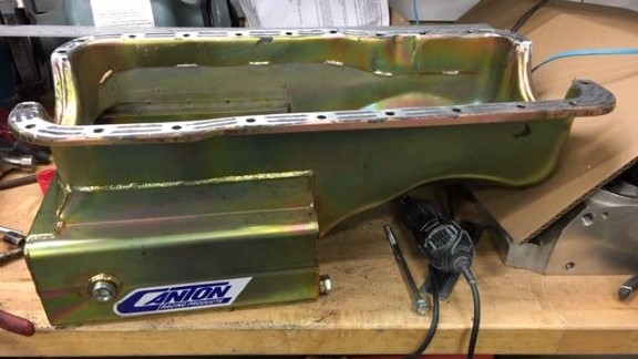

Next I got the Canton oil pan out that 289fia_cobra had sent me sometime back to prep it and figure what else I will need to put it on. He had problems with it leaking. I found one side edge was bent and it would cause quite a gap that would be tough to seal. After a little metal work I have it pretty straight. Should now seal!
It is a front sump designed for cobras. It has a race trap door baffle, crank scraper, windage tray & anti- slosh baffle built in! I will need to purchase a pick up tube and dip stick for it.
http://www.clubcobra.com/forums/pict...ictureid=18864

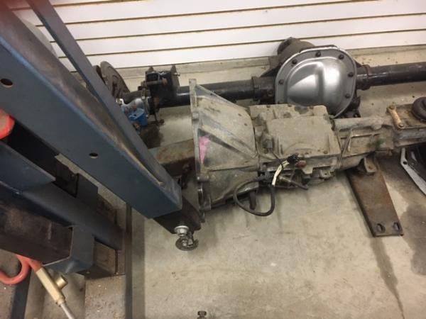

Next came the trans
http://www.clubcobra.com/forums/pict...ictureid=18872

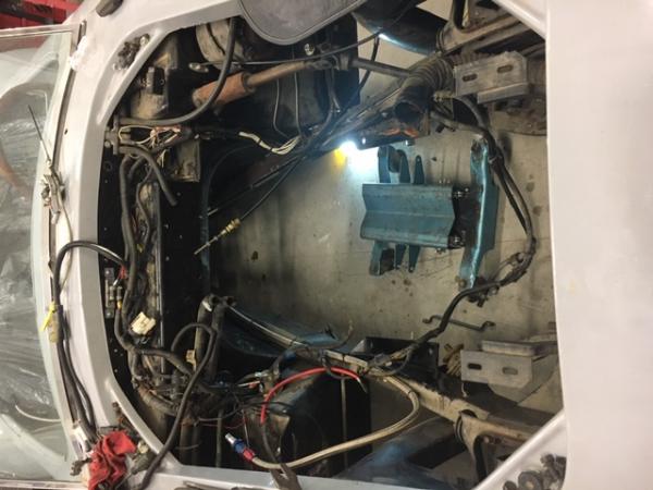

Now I can clean up and paint the engine compartment
http://www.clubcobra.com/forums/pict...ictureid=18871

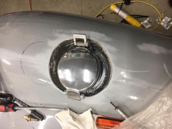

So I install the Gas cap recess well.
http://www.clubcobra.com/forums/pict...ictureid=18966

Where dd you get the gas cap well? Was it one of DV's?
Mr Bruce on this site has them available. I was lucky in that he had a slow moment between the slab side bodies he was building to knock one out for me.
