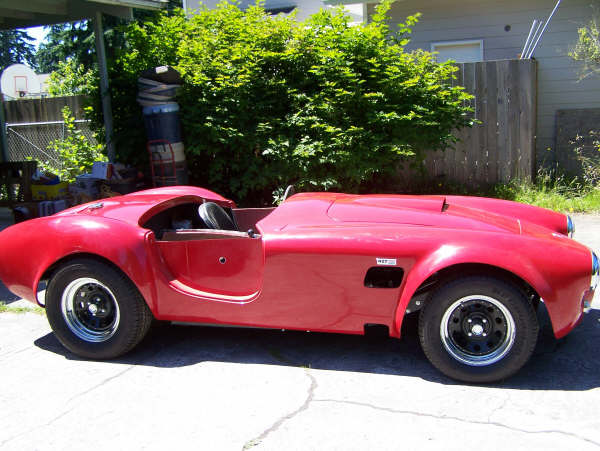

That is looking good. I am going to put one of your pictures in this post for the others to see. Congratulations on getting along so well.
[img]http://www.clubcobra.com/forums/picture.php?albumid=3118&pictureid=13410[img]

Thanks Ron. That was a photo of the car when I bought it. Since the purchase. I removed everything, down to the bare frame. Rebuilt the suspension, added a 408/TKO600, disc brakes etc. As of today, we have completed the interior and mounted Corbeau seats and 5 pt belts. Rollbars are powder coated and installed on both sides. Still needed are tires n wheel and paint. I'll add a couple pics of the interior build.
