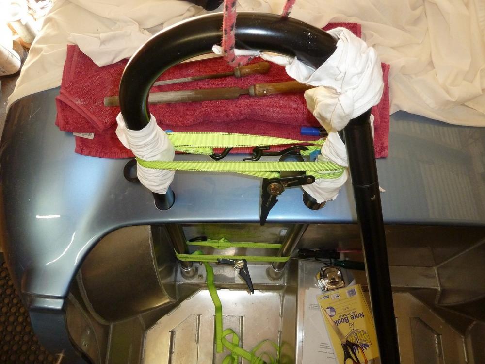

Currently working on the roll-over bar installation. I have had the bar and strut powder coated; I’ve removed the mounting sockets and drilled the sockets and bar legs in conjunction, and remounted the sockets. The bar legs have sprung out by more than 15mm so will have to pull them back in to be able to fit the bar.

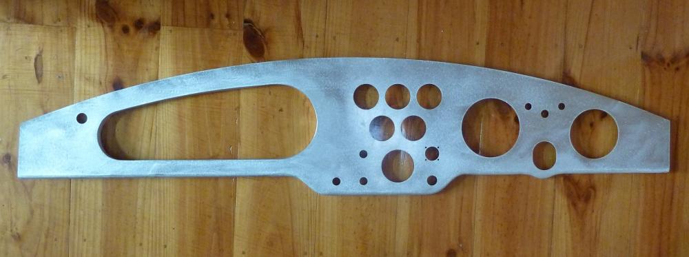

Also have been working on the dashboard. I’ve done a mock-up in mdf and am making ‘adjustments’ to it and to my original CAD model.

Still working on the roll-over bar install, but not going smoothly. As mentioned, legs had sprung out somewhat, so had to deal with that. I wanted to use grommets as per originals, and managed to finally source what I think are correct grommets, but the holes in the body need so much adjustment to allow the bar to be fitted that I think the grommets are out.
I still have some work to do here but here's where I'm at....

Good news is that my dash panel is progressing. Here's what it looks like currently....
http://www.clubcobra.com/forums/pict...ictureid=16578
Luckily I saved enough leather from the same hides as the seats, so have that aspect 'covered'. Steering shaft location is different to originals, but I'm happy enough with the adjustments I've had to make.

Glen,
Coming along nicely. I doubt that there is a cobra build out there that did not need some adjustments. The hole for the outside leg of the roll bar does look a little tight. Not sure how to open it up for a grommet without either making a poor cut or having to remove the roll bar. given the effort that it took to get the roll bar in, I would suggest that you do without the grommets.
If you have a spare set of grommets, you could try to cut away at the bottom of one and see if there is enough material left to still secure it from the underside. It looks like there might be enough space on the inner leg to place a grommet. Or maybe even cut off the underside of the grommet and use a little RTV around the inner aspect of the grommet to secure it to the roll bar in place?

Thanks for the offer Dean, and Jim for the suggestions. I did actually find some grommets that I thought would work (they were designed to fit a 1/4" thick panel, and surprisingly, sourced here in Adelaide) but my main problem was that the holes in the bodywork were incorrectly positioned ....one was too far forward and the other was too far aft. Result was - no amount of available juggling would enable me to use the grommets without gaps showing. I hadn't wanted to use the supplied SS 'washers', but had to concede that their use was my only option. Even still, one washer-securing screw and nyloc out of three for each leg is hanging in the breeze (but you can't see it, and it doesn't matter). The end result is visually quite good - I'll take a pic of it tomorrow and post it here.

Finally got the roll bar install to the point where I am happy with it. I reckon it took 20 hours (:eek:) to get it right.
Every thing is all bolted down tight....and it's not coming out again.
