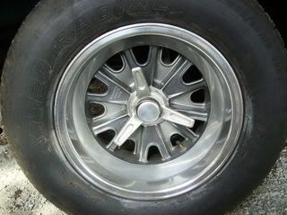

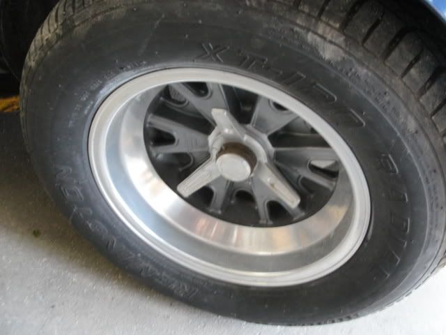

I saw on this particular car that the threaded spindles on the rear wheels stuck out of the wheels like an inch or so, is this normal? All cars I saw with knock-off wheels were more or less flush.

My car is 3624 and the date on the CO is Nov. 1990. My hubs do stick out beyond the wheel, the car is set up with pins through the hubs as safety locks. Hope this helps.
