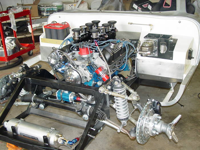

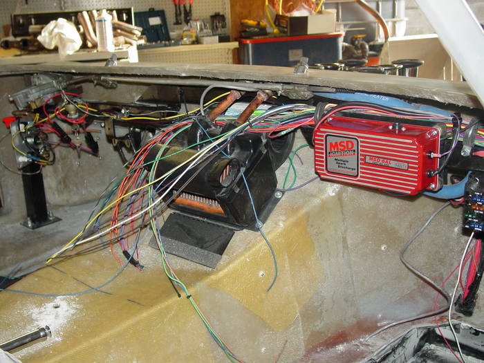

more updates
Getting closer....http://www.clubcobra.com/photopost/d...m/DSC00044.JPG
Wiring too...
http://www.clubcobra.com/photopost/d...m/DSC00046.JPG

Scott S 04-09-2006 08:56 AM
I got the webers hooked together!
http://www.clubcobra.com/photopost/d...m/DSC00051.JPG
One whole day on carberator linkage, who would have thought**)
I may get to hear it run soon!
Scott S
