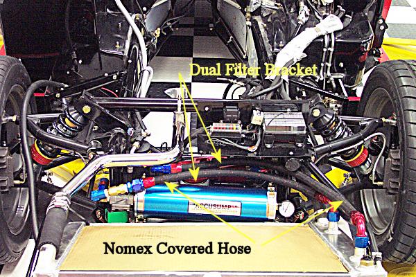

I took delivery of Superformance Daytona Coupe 140 a while back and am doing my own install. I just complete the Accusump installation (photo attached) and am moving on to the fuel pump and filter install for the Roush stack injection. I have read about the placement of the pump below the tank level as an important factor to keep the pump delivery consistent through all levels of gas in the tank. I am also going with a complete side pipe exhaust system which gives more options on the pump and filter location. I really don't want to reinvent this install and am asking other Superformance Coupe owners with the stack injection for photos and/or description of your pump/filter install.
Thanks in advance
