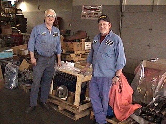

Befoe I totally forget, the distinguished gentlemen on the left is Maynard, with Pat, the machinist responsible for putty Jenny's Cobra motor together is on the right!
And of course the guest of honor is in the middle!

TurnPike Boy...I know it isn't a close up, but even so did you ever think "your" motor would look that good! :)
For those that missed the earlier posts about the search for the proper motor for Jenny's FIA Cobra...may I introduce the guy that has made this heart transplant a reality...TURNPIKE BOY!!!
