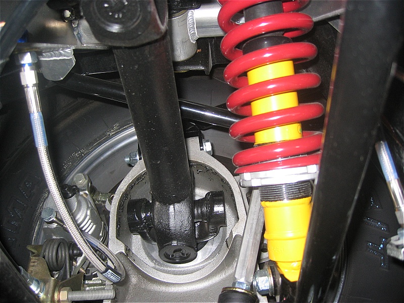

wolf k 04-30-2012 07:28 AM
http://i298.photobucket.com/albums/m...n/DSC00407.jpg
ERA rear, the lower control arm takes away some space but routing exhaust is still do-able with narrowish tires.
PVC mock-up, brilliant Dan.
