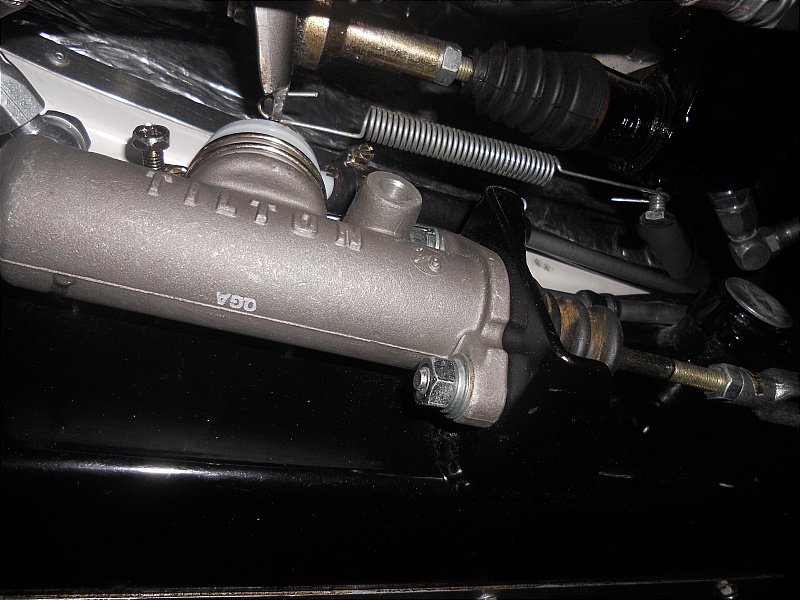

Posts: 22,025
You probably don't need it, but here's a shot of mine for reference. Note that in this shot you can not see the ERA-supplied aluminum spacer between the slave bracket and the block. For perfect alignment, my setup required that.
