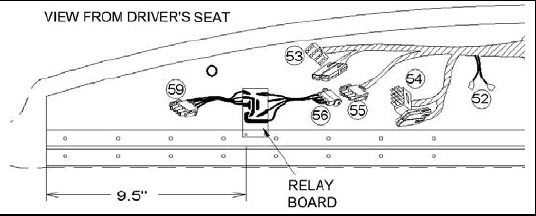

In redoing my dash wiring, I have come upon what I believe is missing wiper motor relay. In comparing the wiring diagram with what I have, it appears that there should be a wiper motor relay between #59 and #56, of which there is a group of 4 orange wirenuts.
So my question is, can I wire it up without a relay, and just park the wipers manually, or is it preferable to use the relay. I know that the early cars (pre 266) didn't have a relay, and I am not sure exactly what to expect either way.

I have both of those -- they look good. The "wiper relay" is really a little circuit board that is mounted on the driver's side of the firewall. You really can't miss it if it's there because it looks like a piece off an old smashed transistor radio. IIRC, it turns the wiper motor in to a generator momentarily to slam everything to a stop. I've probably turned my wipers on twice since I've owned the car -- and only just to see if they work.
Old 10-29-2012, 02:15 PM
Posts: 22,025
Here:

Earlier cars' wiper relay were only connected to the dash harness with a single 4-pole plug. (Very early ERAs used the original round switch with screw-on terminals. That switch is no longer available for anything close to a reasonable price.)
The other end of the early relay harness went through the firewall and connected directly to the wiper motor. I'm not sure what's going on with your car, since the relay appears to be completely missing. At any rate, you don't need the relay if you are willing to manually park the wipers. The wiring troubleshooting guide has information on what goes where, and why.

My wiring is just like the diagram as shown by Pat, with 55 branching off from the front harness and coming down, connecting to 56, with no relay.
Bob,
Can I purchase just the switch (rotary) and the relay, so I can return to normal operation, or is the early wiper motor wired differently that it doesn't work with the relay?

It looks like that's not the original harness (judging from the connectors shown in the left side of the picture). The question is, do you have the wiper switch with the screw-on connectors? If so, I can make a connector that will interface with it to the current plug that connects through the firewall to the wiper motor.
