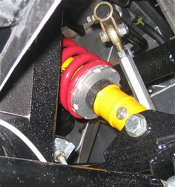

Well, here's the old SPAX...
http://www.clubcobra.com/photopost/data/500/spax1.jpg
patrickt 04-17-2014 12:47 PM
Here's a Quiz...
From the pic, which shock is that?
Murky781 04-17-2014 12:50 PM
The dirty one.
