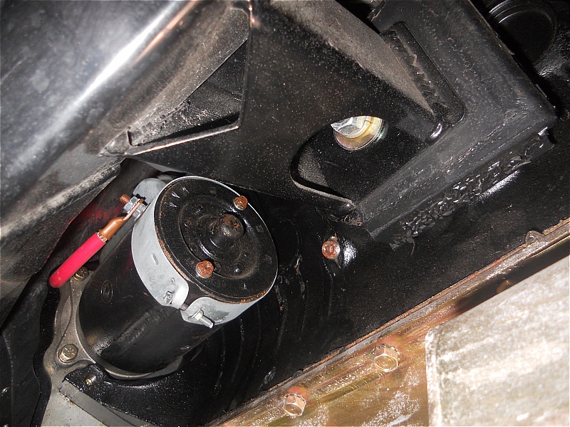

So, continuing on my starter issues, today the new starter failed. Teeth were ground enough on it and the flywheel has some teeth chewed but not entirely broken. At this point, I think the old starter damaged the flywheel and the new starter was damaged by the flywheel. I know of no other way but to replace both to solve my problem.

I am trying to figure out the cause. Is it possible that there is just enough play in frame / bolt holes that the starter is vibrating loose.I am not sure how to cure my issue unless it is exactly as I said, (i.e the old starter damaged the flywheel and the flywheel then damaged the new starter.
Pictures should be uploaded.
Phil

Another of the new one. Now another old one...

You may have the incorrect starter for your appplication. It looks like it should engage further into the flywheel, the nose piece for the starter may need to changed, to allow the gear to extend further into the flyfheel IE: more tooth engagement.

Thanks Rick. The starter is the CVR recommended for Shelby Blocks by the ERA manual. Its a CVR brand.

The CVR does only have two bolt holes, top and bottom and the belll housing has top bottom and one at the 9'O clock position. Its the one that came with the car, thus I replaced it with what came off of it. The old one had about 1,200 miles on it. I tried the other option of a powermaster and the bolt holes did not line up.

As far as the CVR starter ,I`ve had no luck with them and also broken the pinion shaft ... went with a RobbMc starter and it fits perfectly ... and all three bolts line up instead of two like the CVR unit .

Ok, thanks for all the advice and knowledge. After looking closely at the flywheel, no teeth are broken, some marred, but I think will still work. I am told its a 184 tooth flywheel and that the CVR may be the wrong starter for that flywheel. Danbury explained the differences. The CVR does not appear to engage fully into the flywheel. I will look at a Robb MC starter and see if that helps before I go the full boar route of pulling everything. Fingers crossed.
