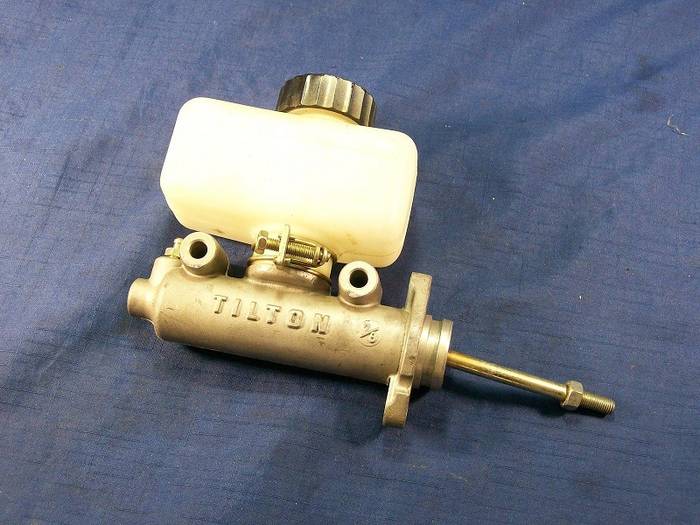

I was bleeding the front brakes today on ERA164. I opened the first bleeder on the front and when I went to pump the pedal it depressed as I would expect through about 50% of its travel, then got stiff for a moment, and then collapsed to the floor (the reservoir was full). Now I have a never ending supply of air exiting the system at the bleeder.
I pulled the master cylinder cover and there was some fluid leaking into the boot of the front brake cylinder which I assume began with the odd pedal travel, because the inside of the cylinder cover was dry and they have never dripped onto the floor in the past. So I guess I'm in the market for a new cylinder.
My question is do I need to replace both cylinders at the same time? If not, I'd prefer to just do the bad cylinder as it will eliminate the need to pull the inspection panel to bleed the rears.
If I can just replace the bad cylinder, I assume I shouldn't mix two different makes of cylinders. The manual says that from chassis #220 on, Tilton cylinders are used, but doesn't specify what was used prior. It's definitely not the Tilton on there now. I attached a picture of the cylinders. They're stamped with V-1089 and a Google search seems to indicate they're Volkswagen or aftermarket Volkswagen replacement units. Anybody recognize them?
If I do have to replace both at the same time, is it correct to assume that the Tiltons can replace these without modification on a pre-220 chassis?
Also, based on the manual, it seems to me that the balance bar is angled improperly...that it should slant away from the outer/front cylinder as opposed to towards it. Any idea what's going on here along with the bent rear cylinder push rod? The brakes have always performed nicely and the fronts lock up just prior to the rears, but the setup is a bit different than the manual describes.
On an unrelated note, should the pedal needle bearing be lubricated while I've got the cover off, or not necessary?

I don't know all the answers but that bent push rod definitely does not look right to me. Not sure what is up with that - but I suspect it isn't right. That would also affect the balance bar setting. I suggest calling Bob or Doug if Bob doesn't chime in on your thread.
You only need to replace the master cylinder that is leaking - no need to replace both. However, while down there and bleeding brakes you might want to do it now to possibly avoid doing it in the next year or two.
The needle bearings are not subjected to continuous duty so they are probably fine - but it could not hurt to lube them if you can.
That's because it's BTBB (big time bent & busted). It has to be replaced and then the balance bar is set up on an angle -- it's right there in the manual. I'm not even sure how someone managed to do that to the rods, but it's definitely BTBB.

Yes, and I forgot to add that the eccentric loads on the MC piston with the bent rod is probably what wore it out and caused it to leak. (Assuming that is the one leaking). The piston drag on the bore wall is probably what caused it to get stiff when bleeding, before it slipped and bottomed.

That link should definitely be straight...
Here is the page for servicing the VW master cylinders.
http://www.erareplica.com/427man/brakes/index.htm

Didn't think to check the online manual, but the part number there is the perfect info.
I'll just replace both cylinders since I don't know how long the pushrod has been like that and possibly damaging the cylinder bore...surprisingly the one that is leaking has the straight link.
The rod end bearing on the bent link was completely seized in its bore which I guess caused the bend. Anyway, I'll get them fixed up.

It looks like someone used allthread rod to make the pedal shafts. That stuff is soft steel, easily bent and not suitable for brake rods. This car was built by an idiot who does not understand the forces generated by a person standing on a brake pedal under serious deceleration.
I would order new Tilton (or Wilwood) master cylinders and use the shafts that come with them. These have a special shape with a washer and circlip that keep them in place. You can see in the picture below that only the end should be threaded. Make sure the cylinders have the same bore diameters as your originals. You can get these on eBay or Amazon very cheaply.
However, from your picture it appears that the shafts may be longer than the stock rods. I would look for a way to move the master cylinders closer to the balance bar. If that's not possible, I would have a professional welder attach a grade 8 bolt to the end of the rod. If that's necessary, I would also have him weld a sleeve over the welded joint to make it much stronger.
This is important (life or death) stuff and you don't want to screw around.
