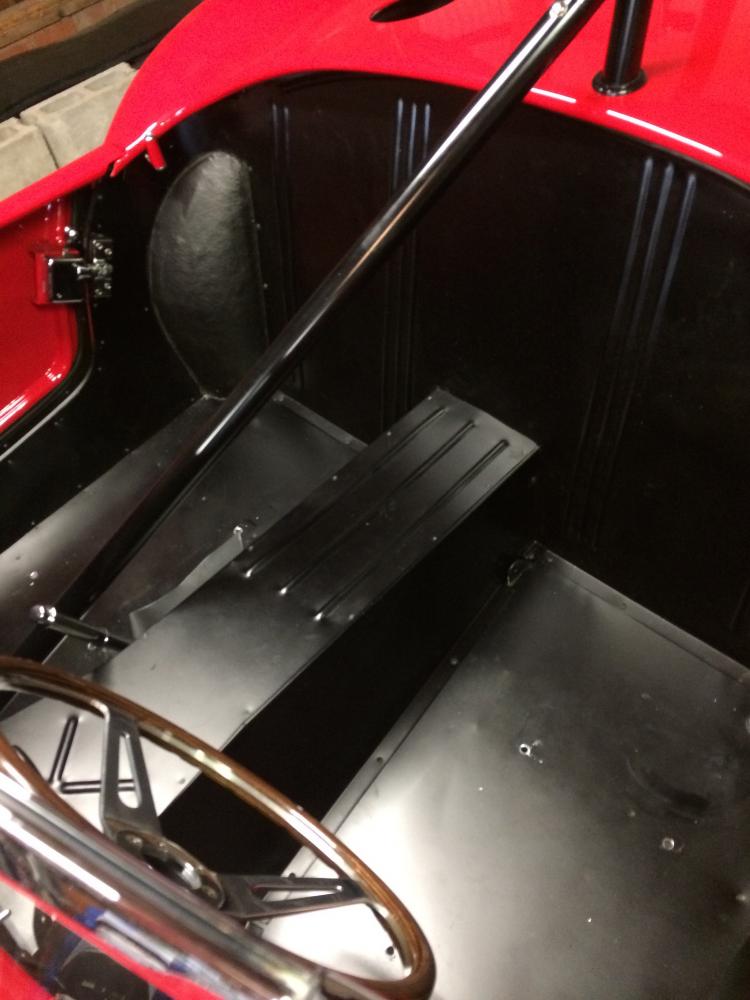

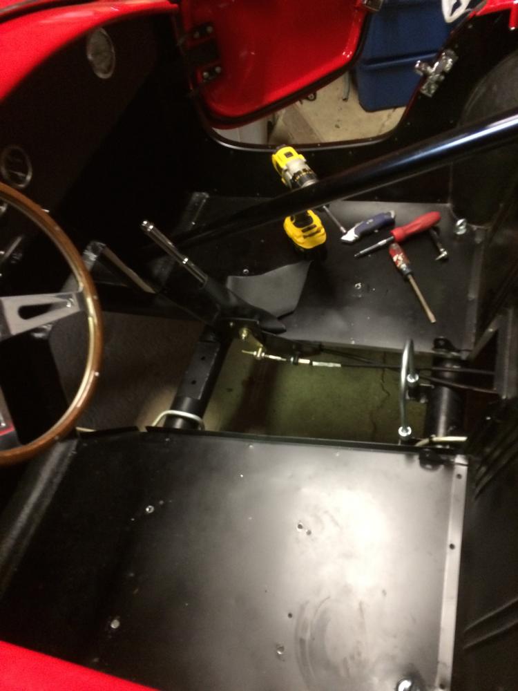

By the way, my roll bar is now black and I like it!
https://lh3.googleusercontent.com/yR...g=w465-h328-no
https://lh3.googleusercontent.com/OJ...w=w782-h531-no
