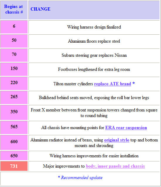

And that is completely different from this stuff that started on #731 and above?
New body mounting tubes, at the nose opening and underneath the cowl.
New-style bottom radiator mounts.
New front frame horns, side tubing and bumper mounting system.
New aluminum front wheel splash panels. The rear panels are removable for battery and exhaust access.
New tubes from cowl to front suspension
Wider footboxes.
New original-style throttle mounting.
Original-style fresh air valves on both footboxes.
Original-style wiper mount on footbox.
New front battery support.
Curved outer cowl support tubes for wider footbox.
New formed outriggers from main rails to side rails
Slanted side rails for smooth transition from floor to door opening
New floor design.
Extra reinforcement for side intrusion protection.
New Aluminum tunnel.
Stronger door latch mounting system.
New rear splash panels.
Aluminum trunk panels
Last edited by patrickt; 04-24-2008 at 10:26 AM.. Reason: Added Pic of ERA Update History

The changes mentioned by ZOERA began at #731. I put another break at 758 because we changed the steering gear and mounts (which actually haven't made it into the manual yet...).
As far as the body change mentioned by Bobcat, we're trying to figure out what's going on. Same mold, but the lower body seems to be 3/8" higher in the front relative to the chassis. Not a bad thing because the oil cooler scoop is really low.
