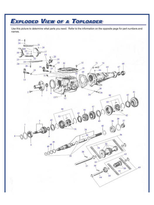

The Ford Toploader Transmission Manual can be found here: http://www.classictiger.com/techtips...dr/topldr.html

If the interlock pin is missing between the shift rails, a Toploader can go into two gears at the same time.
08-21-2008, 12:06 PM
Posts: 22,025
Interesting. That pin would be #27 on the view below.
