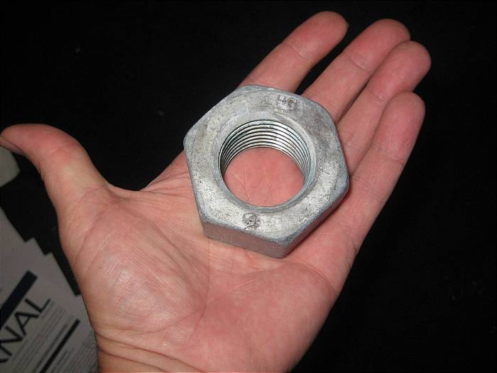

Old 07-07-2009, 08:10 AM
Posts: 22,025
Originally Posted by RICK LAKE View Post
Drill holes through the other side of the bolts. They may come loose but will not come out.
Well I fixed it this morning. On your advice, I used a pretty serious nut on the back of the bolt. Take a look...

Ok buddy, I'm with you. As for the loose shifter bolts - been there twice. The first time it was the top bolt that worked its way out and I used some wire to tie it up and continue to the nearest hardware store. The second time, the shift handle actually broke across the bolt hole. I had shortened the handle by grinding a flat section above the old top hole and drilling a new one. There wasn't enough meat left and the darn thing broke right off in the middle of an upshift. Luckily I had visegrips in the toolbag and that became my shifter for the rest of the afternoon. Looked pretty trick actually - if you squinted and tilted your head just right, it kinda looked like a lenco or some other fancy drag setup.

I had a similar experience on my Classic Roadster which has a T-5Z
transmission. The throw in shifting got very long and sloppy while on the
way to a cruise-in. It worked ok until I made it home. the two bolts went
through the post and were screwed into the lever which was threaded. One
had worked free and the other was lose. I got longer bolts and put nuts with
lock washers on the other side and no more problems. No interference with
the added length.
Flip

That location and the back and forth motion would be best served by a couple of shoulder bolts. A normal grade 8 bolt with threads baring on the surfaces within the hole of the shifter and the "Stub" from the transmission will ultimately elongate the hole, causing looseness and damage to each part.
