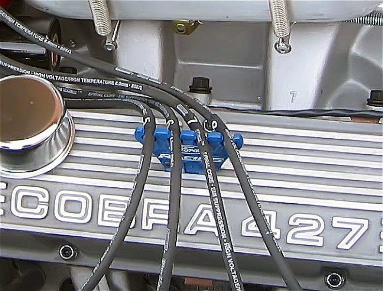

patrickt 10-01-2010 07:26 AM
Or...
Originally Posted by DougD (Post 1081241)
The 8mm+ wires are too large for the factory valve cover wire holder thingys, so you will need to buy a set of Moroso or some other brand wire separators, drill a couple of holes in them, and rivet or bolt them to the valve cover tabs.
Uhhh, I submit that's easier than making your own wires. Or just buy fatter looms, like I did.:cool:
http://www.clubcobra.com/photopost/d...sowires001.jpg
DougD 10-01-2010 07:38 AM
Patrickt
Whatever brand wire he chooses, he'll still have to make up a valve cover holder thingy if they're over 7mm.
Since he's always concerned with appearing original, I suggested a universal Moroso or other brand. The ones I used come in black, and are close to the same size and shape to the original Ford holders. Your blue ones are kinda blingy......
Making up your own custom length wires isn't hard.
patrickt 10-01-2010 07:42 AM
Originally Posted by DougD (Post 1081244)
Your blue ones are kinda blingy.......
:eek::eek::eek::eek:
He can't do it without screwing it up.;) If he made his own plug wires he would be complaining that his car was now missing and backfiring.:p
