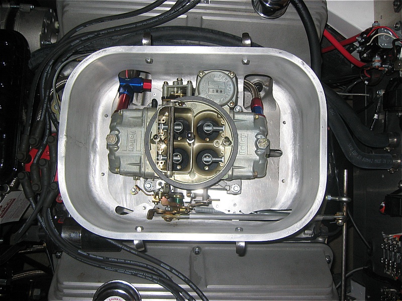

Put your springs underneath your TP. I run a Holley, but here's a shot of mine from up top.
http://www.clubcobra.com/photopost/d...nspring001.jpg

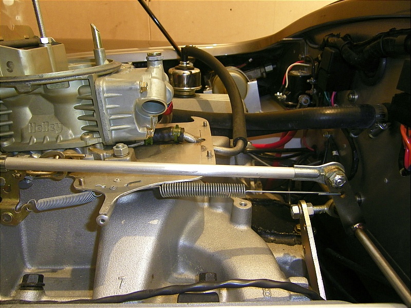

patrickt 02-12-2011 06:38 PM
This shows it better.
http://www.clubcobra.com/photopost/d...spring2001.jpg
dcdoug 02-12-2011 06:39 PM
Most run the spring back to a bracket mounted to the two holes on the intake behind the carb. Those two holes behind the right spring in Pat's pic. Mickmate sells a nice one if your are looking.
