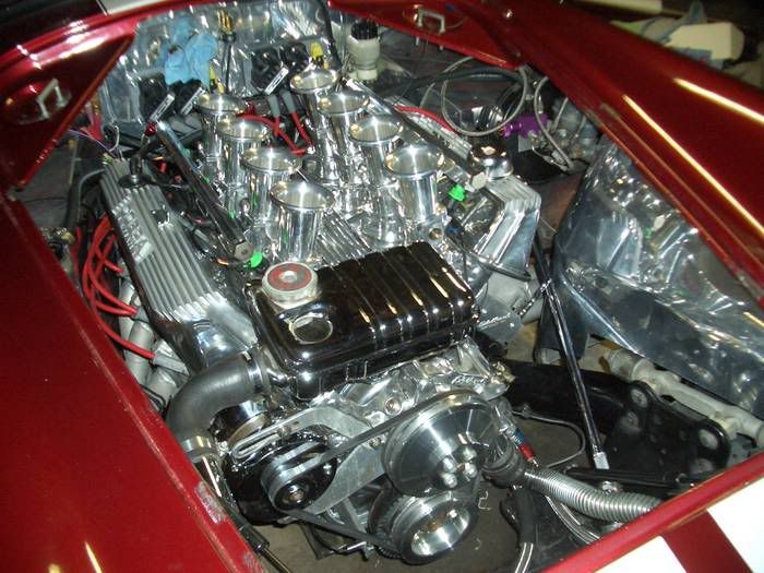

Here's a set of TWM stacks on a 427FE that went into a Kirkham.

DB Replicas, thanks a lot, that is what I was looking for. Since we'll have a big block FE in a Kirkham looks like we'll go with the angled. Do you know how many degrees on that picture? 10 seems to be the norm.
db replicas 04-20-2011 02:57 PM
Yes, I believe they are canted at 10 deg.

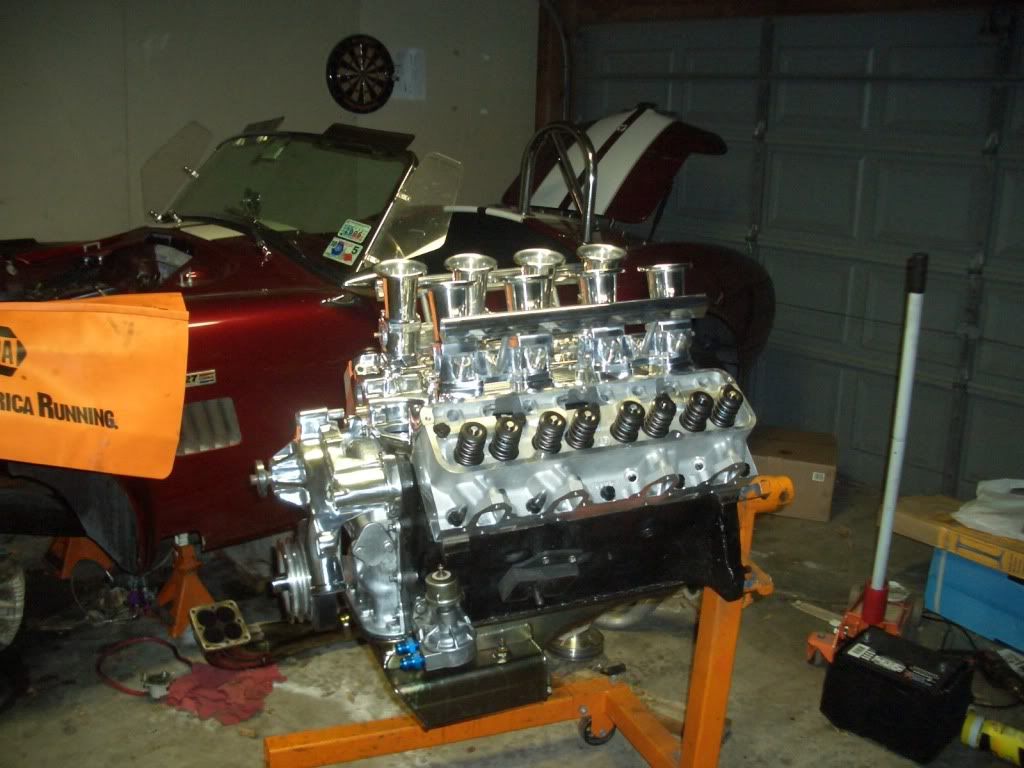

Here is a TWM intake for an FE, with the FAST Ez-EFI system. They don't make too many of these. We had to wait a couple months to get this one. Hopefully Barry will be able to finish the engine so I can post pictures of the whole thing together.
http://img.photobucket.com/albums/v7.../twmintake.jpg
