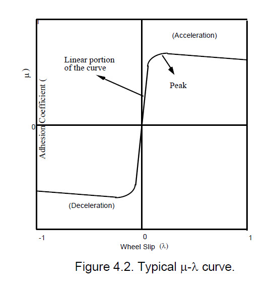

Here's a Graph
Rick, I still want someone to explain why I would want a clutch that held more than the PEAK point plus a small safety margin. I think Brent is on record here stating that as clutches go up in "hold" ability, so does the chatter on the street.
http://www.clubcobra.com/photopost/d...0/adhesion.jpg

patrickt 10-20-2011 05:23 PM
Forget Centerforce for the moment (and yes we removed those little gimmicky weights). Is there a benefit to having a clutch that has a hold ability that is greater than the peak point on the graph? And if so, what is it?
blykins 10-20-2011 06:01 PM
I usually aim for the engine's horsepower + 10%. That way if the customer decides that he/she wants to hit it one time at the strip with drag radials or slicks, the clutch will hold.
You're right, as the clutch disc's coefficient of friction goes up, the possibility of clutch chatter goes up as well. However, the weight of a Cobra really helps out here (as does a lower rearend gear ratio) and I can usually match a Cobra up with a sintered iron clutch disc and not have any issues. Where I really have to watch my P's and Q's is when I spec a clutch for something like a Galaxie or Fairlane with a 3.00 gear.
