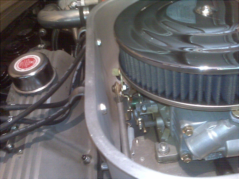

It's pretty tough to wrap a Turkey Pan around dual carbs. Personally, that's one of my favorite looks to these cars -- you don't see it anywhere else. That's the main reason I went with a single. Plus, it's ridiculously easy to tune my single Holley four barrel and the center hung floats are an advantage in the corners (that's at the bottom of the importance scale to me, but to others it can be at the top).
EDIT -- btw, I'm told that the Turkey Pan increases steetability by helping to prevent the heat soak percolation in the carb from the heat. I don't know that to be a fact, though.

If you do end up going the Turkey Pan route, make sure you have one fabbed that is easily removable. If you have large hands (no offense), it is a real nuisance to do anything with a carb in a Turkey Pan. I had mine custom fabbed to be removable, and that's going on six years ago. Since then a couple of folks on here now provide "removable Turkey Pans" and they are well worth the added expense. See, Turkey Pans bolt under the carb, and over the intake manifold, so if you wanted to do somethink like change the little cam for the squirter, or even just adjust the idle mixture screws, it's almost impossible to get your hands down there. I tune my carb with a vacuum gauge and I don't think I could even get the hose on the fitting under the front of the carb if the TP wasn't removable. Some TPs have little holes in the side, which helps, but if you want to do somthing other than just turn a screw a TP that is not removable becomes a huge PITA.

patrickt 10-03-2011 10:38 AM
Now on the other hand, Undy would have no trouble getting his dainty paws in there to switch out the pump cam.:LOL:
http://www.clubcobra.com/photopost/d...ightfit001.jpg
