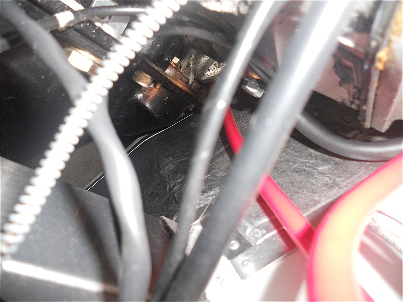

I'm sorry, I meant to write "bolts up evenly." Here's a shot of mine -- does your starter actually pass back behind the plane of the block?
