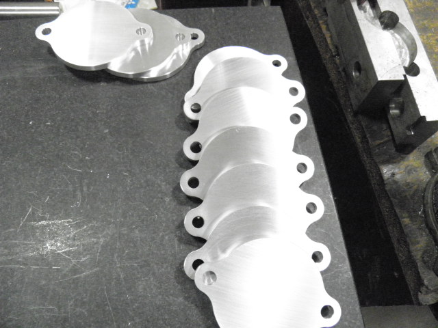

FWB 08-06-2012 06:27 AM
Bret, the plates you see guys using, mostly are dove cast ones, or made up custom.
i keep these in stock, plain not drilled for a grommet. machined from solid alum, not cast.
i'm 15 minutes north of you up 7th st. if you want to see them.
there is also an old for sale ad with pics. have about 30 in stock.
Fred

FWB 08-06-2012 09:09 AM

http://www.clubcobra.com/classifieds...e/P2280124.JPG
