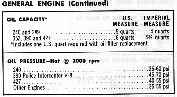

Straight from the Service Manual...
http://www.clubcobra.com/photopost/data/500/oilp001.jpg
Bernica 04-02-2016 03:46 PM
That's right about where I am.:cool:
