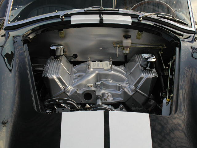

HotRodJoe 04-19-2004 05:00 PM
Update 4/19/04: Car is finished (actually, got it driveable about 10 days ago)! Here is a picture of the engine. More in my gallery....
Joe
