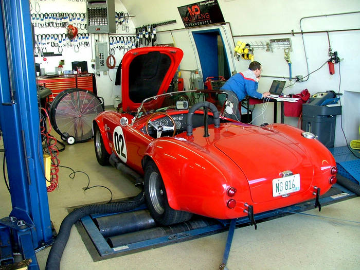

I finally got to try the different filters for my fuel injection on the dyno. The chassis dyno was not working properly so I was only able to do comparitive runs to see how much difference there was in the two filters.
http://www.clubcobra.com/photopost/d...um/Feb2006.JPG
To my surprise there was only 5.2 HP difference. The tuner basically said that for all practicality they were both the same. This did not seem correct to me as with a carb you see a difference in HP by changing or eliminating the filters.
http://www.clubcobra.com/photopost/d..._03-2007_3.JPG
http://www.clubcobra.com/photopost/d..._03-2007_1.JPG
I called Bob Ream at Imagine Injection to see what the factory had found the difference to be. He confirmed my dyno results by saying their tests showed no difference in HP between either types of filters or no filters at all. He thinks that because the FI is controlled by the computer that is continually compensating for changes in air, fuel, temp, ect you don't see the differences in HP you see with a carb.
If there is no difference I just need to decide which to use. The small individual filters sure show off the injectors. I'm thinking thats the way to go, what do others think?
Dick
Rwillia4 03-24-2007 12:34 AM
If this is the case fro HP, I agree the small ones look better. Do they filter as well?
lamaluv 03-24-2007 07:27 AM
The small ones have a foam element between two screens and will keep out small rocks :3DSMILE: but seems prone to getting holes in the foam if you get a back fire through the air valves. The big filters are more of a paper type element and probably do a better job of cleaning the air.
Dick
bobcowan 03-25-2007 10:54 AM
The dyno doesn't tell the whole story - as is usually the case.
At speed (100+) there's certainly a differance between the open stacks and the oval filters. I'v tried it. I get about 8mph more on the front stretch with the open stacks, compared to the oval filters. I have not tried it with just the "tea strainers". Maybe I'll try that the next time out.

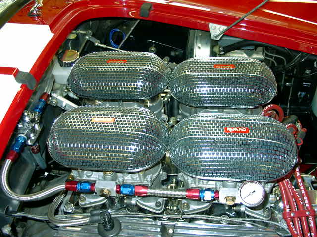

J Persons 08-09-2007 07:54 AM
Below is a picture of the Ram-flo filters I currently have. They may work with your stacks but do not "slip-on." Takes a little time to remove or replace.
http://www.clubcobra.com/photopost/d...93IM000489.JPG
I had a pair of those ram flow filters on a Lotus Cortina with 40 DCOE's and couldn't get enough air through them to run at anything above idle! Switched to some modified K&N filters and it ran great.
This is probably your best bet for an affordable and efficient air filter. Scroll down to the Weber section for the applications. Available for both the IDA and IDF.
http://www.knfilters.com/Racing/customcarb.htm
